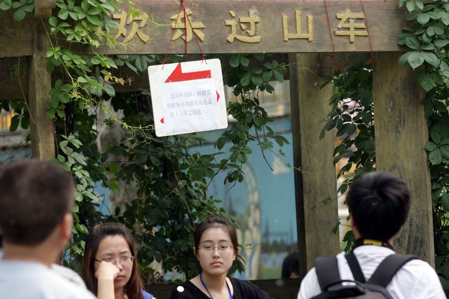

13:40 on May 1, 2012, Shijiazhuang Botanical Garden Fun City, a running roller coaster Occured with an unexpected Accidents, the front and the body out of joint. broken roller coaster still remain on track, the accident occurred about 20 meters distance from the station, lot of people are frightened After unexpected situation , but fortunately no people get injured. This roller coaster was built by Hebei Metallurgical Equipment Co ,open in 2005.
