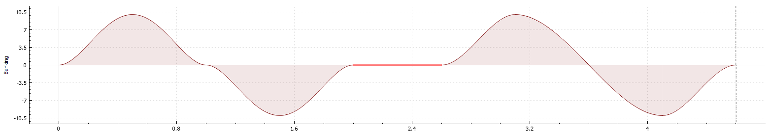

Here's an example of what I mean; left of the highlighted section is two quartics, each are 10m long peaking at 10*/s and -10*/s respectively, on the right is three cubics with the first being 5m long peaking at 10*/s, the middle is 10m long peaking at -20*/s (to get it down to -10) and the third is 5m long peaking at 10*/s. The left one will bank left, pause, then bank right back to 0*. The right one will bank left then right in a fluid motion. Ultimately they both end up at the same roll and in the same distance, but one of them is more 'comfortable.'
