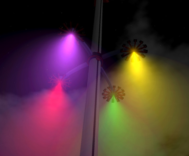

This is the adjusted script for a quattro-lamp. It??????s not ready and i would love if anyone could help me if there is a issue or if it could be easier. But,.. it works! Simply copy&paste this into the win notepad or notepad++ and save it in the "SpinningStar-byfreefall" folder as: QuattroLightScript.nlvm ! After saving, click on the model in the NL2 editor and open the NL2SCO Editor (the model should now be loaded) and go to the Script-Tab. Add here your saved "QuattroLightScript.nlvm" and click on save. Reload the scenery - object aaaaaaaaaaand: It??????s done.

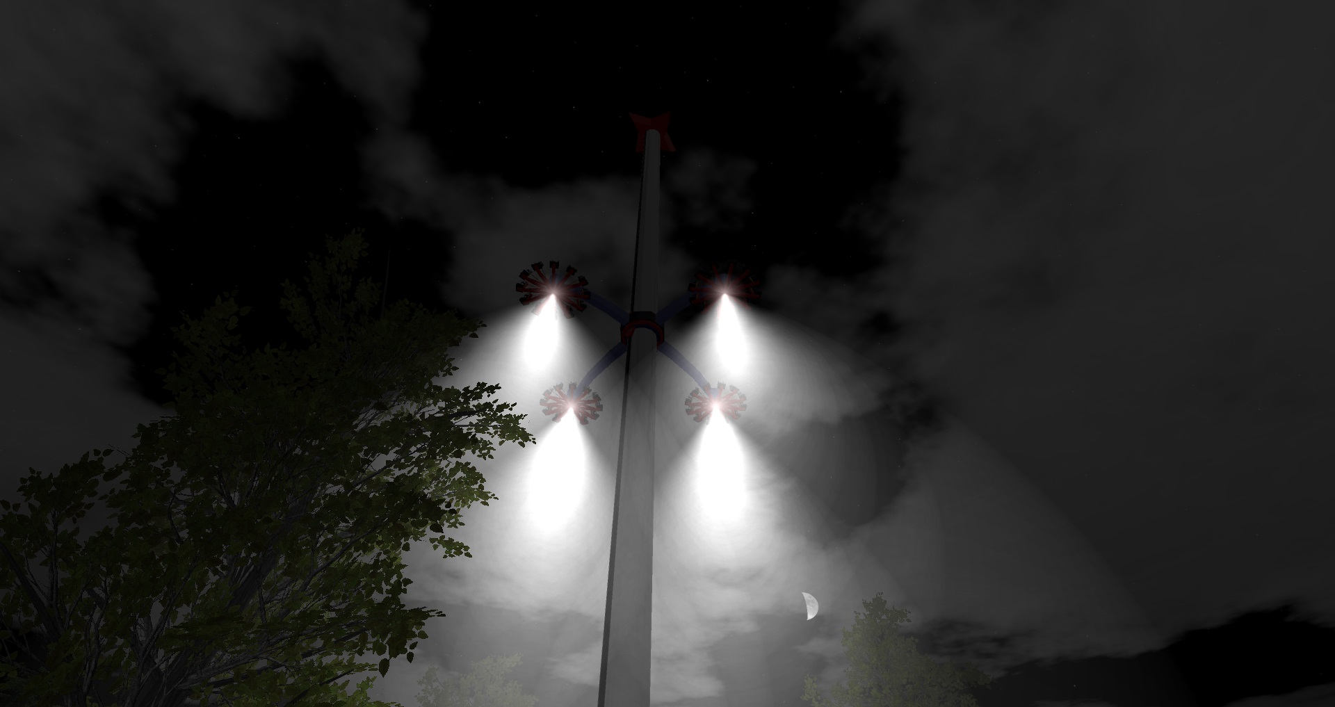

The result!
I hope i could help ;)

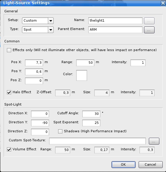

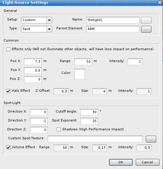

Here are the four light settings:
The first light ...

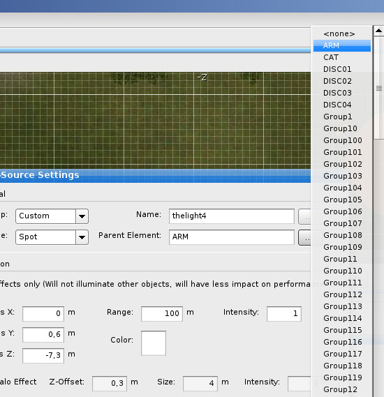

Make sure the lights are attached to the right parent object, which can be found in the list:
ATTACHING YAY!

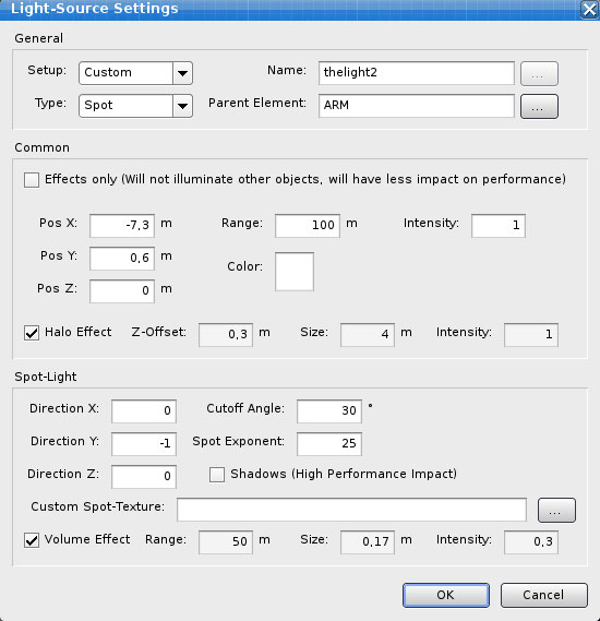

As you can see, the second light having the same settings, except the Pos X ...which is now -7,3 meter!
The second light ...

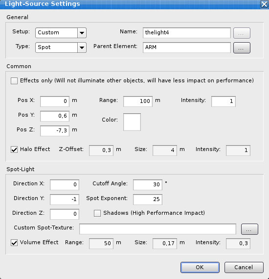

And the last one is also moved to -7,3 meter on the Pos Z Axis :D
The fourth light ...

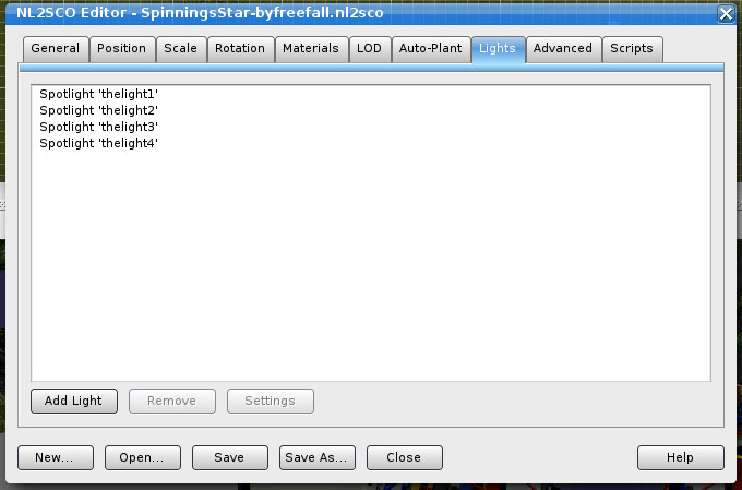

All lights with names!
...at the end, you should have these four lights!

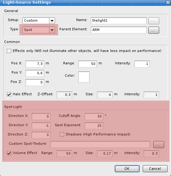

Further Tips:
- Make sure you have selected the SPOT not Omni-light!
- If you have the Spotlight selected .. the window for the spotlight will set the light-settings!
The settings for the SPOTlight...

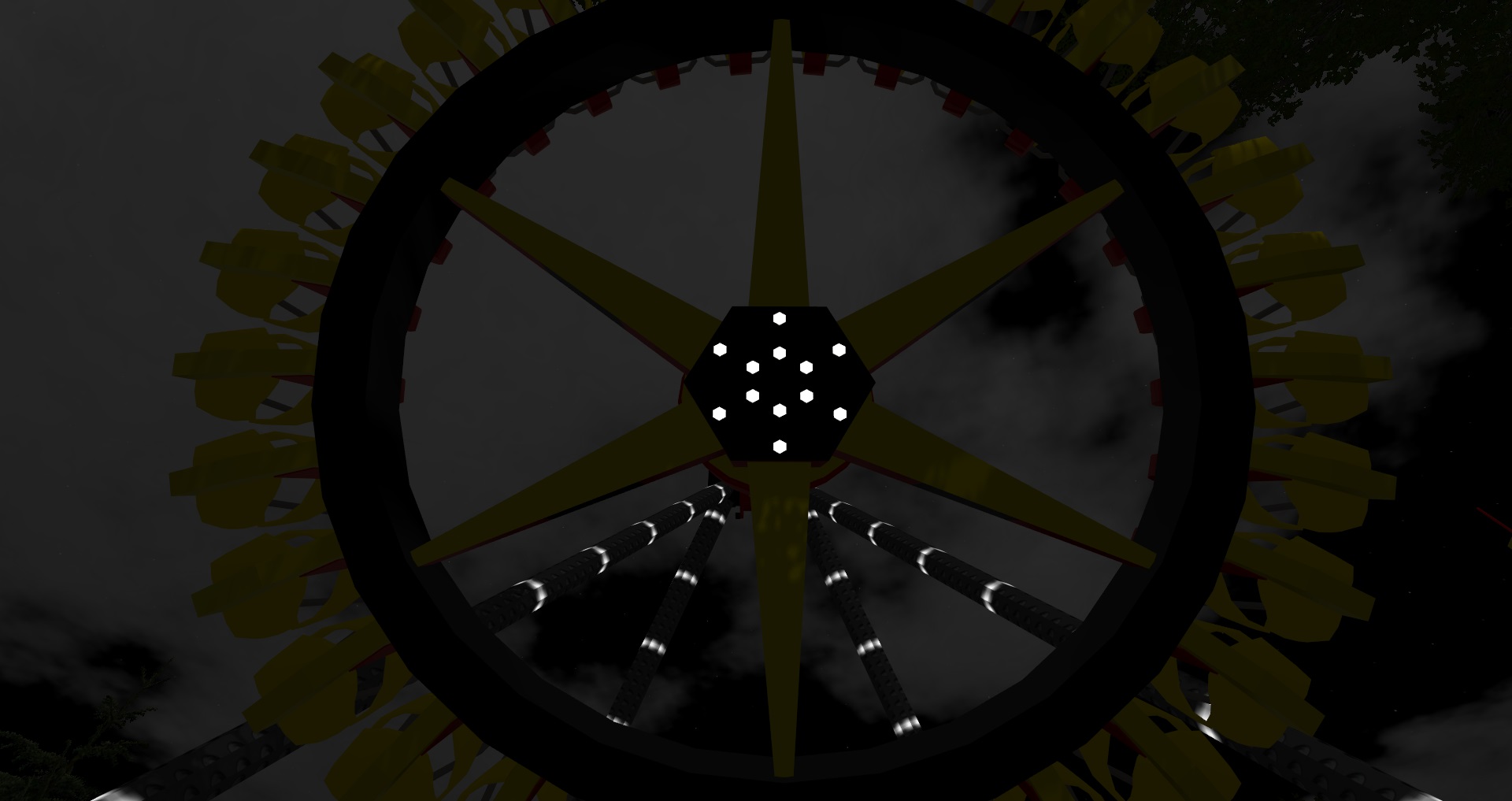

I've got it working!
I found out by accident that I need to restart NL2 after applying all of these changes.
Also, I have the color set as different colors for each vehicle, but they only show up as the color set for "thelight4". Is there any way to fix this?
Posts: 191
Points on hand: 769.00 Points
/o\ ...yes it??????s the script. It??????s not written for multiple colors, since it replaces some materials for the day&night circle. I??????ll look into it later to find a solution!
Looks really cool! Never thought of that idea but it looks really awesome! :D
Nice greetings!
Oscar User avatar
Posts: 14413
Points on hand: 12,363.60 Points
That looks amazing!
Wow! That looks really cool, why hasn't someone done this sooner? Nice job!

PLEASE READ:
I??????m not a coder or scripter =) Maybe there is a way with less lines and a better solution! As for now, it works! :D

Magu78 wrote:
Found the issue!
New Code:

Thank you guys =) By the way the original script can be found in NoLimits2. I??????ve only adjusted it to work with more than one light :D But yeah! I shouldn??????t underestimate myself! There are already a lot of work and thoughts gone into those ride =)
@lol240: Yes, it??????s a fantastic idea of NightwindElf! I never thought of that, but it??????s looking really great :D I just have to figure out how the bulps are working so "Tango"lights will be possible in the future =) Would be great to have a small "carnival" feeling on this.

Hmm,.. that reminds me of thinking about lights.
It??????s possible, with a few changes to make something like that:
(Note: please ignore the distorted light texture on the supports, thanks! ;) )
At the moment i remodel the Gyro Swing and maybe it??????s a good idea to include some "spots" for lights? Or at least a changeable texture where everybody can make some light-patterns with the Light Pattern Creator for the ride?
The lights don??????t cost that much ressources.. and are programm-able. But there are no halo-effects like the spot light.
