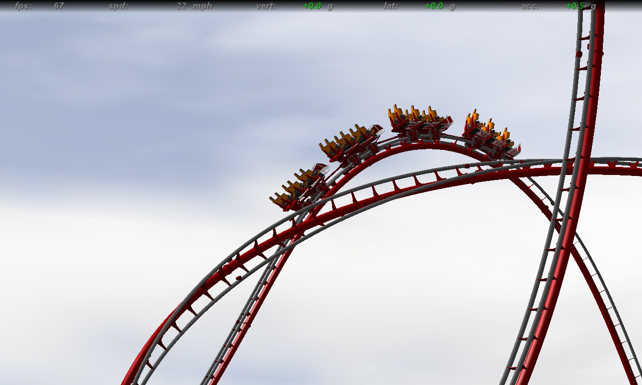

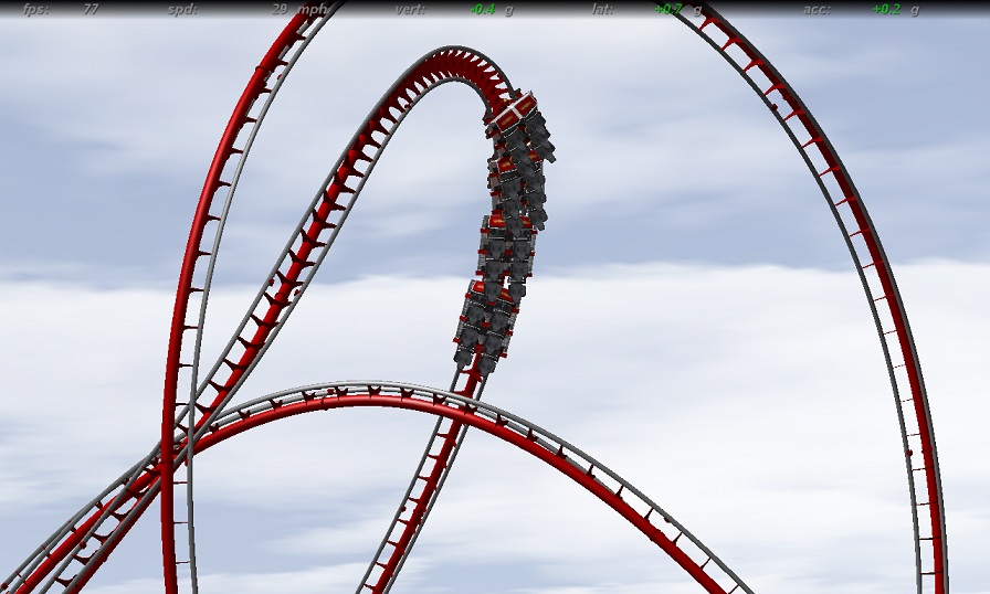

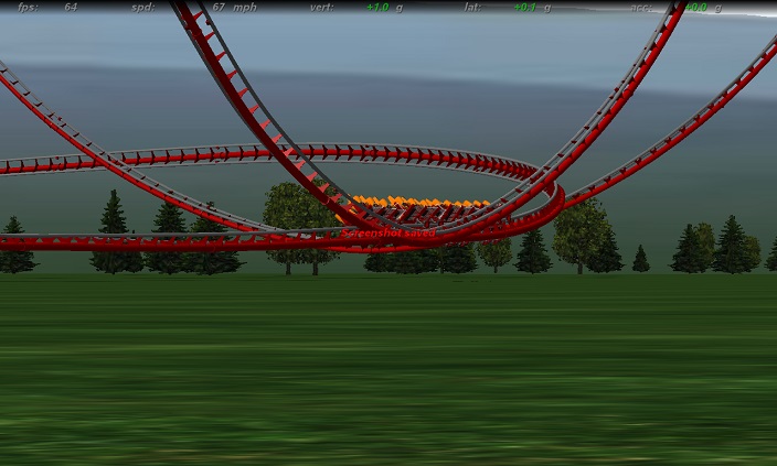

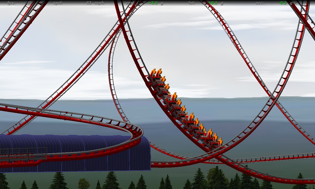

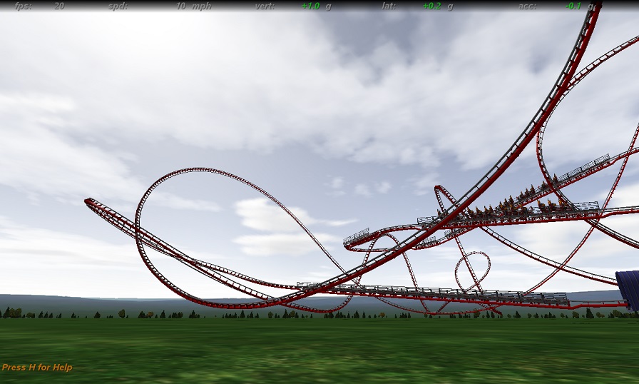

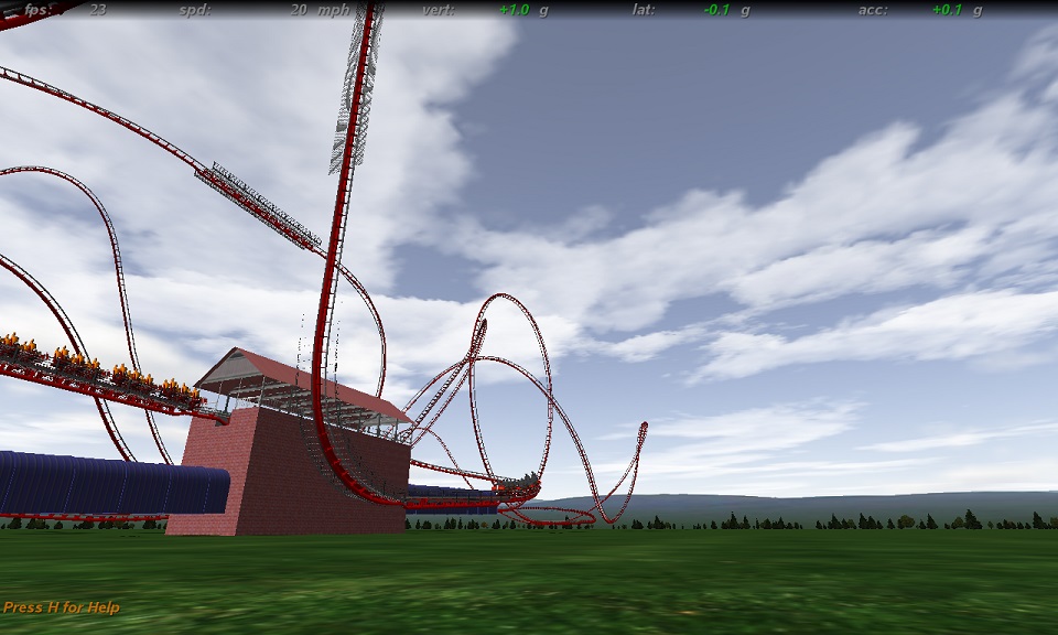

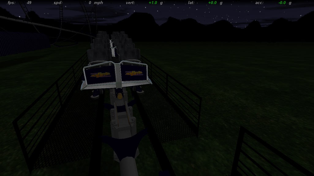

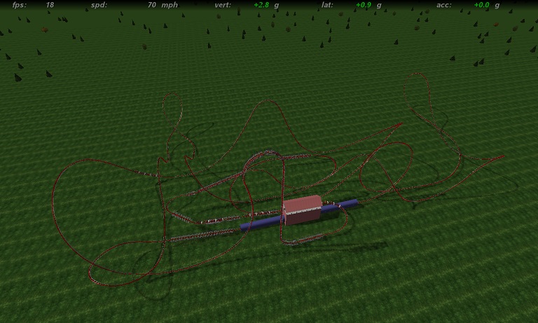

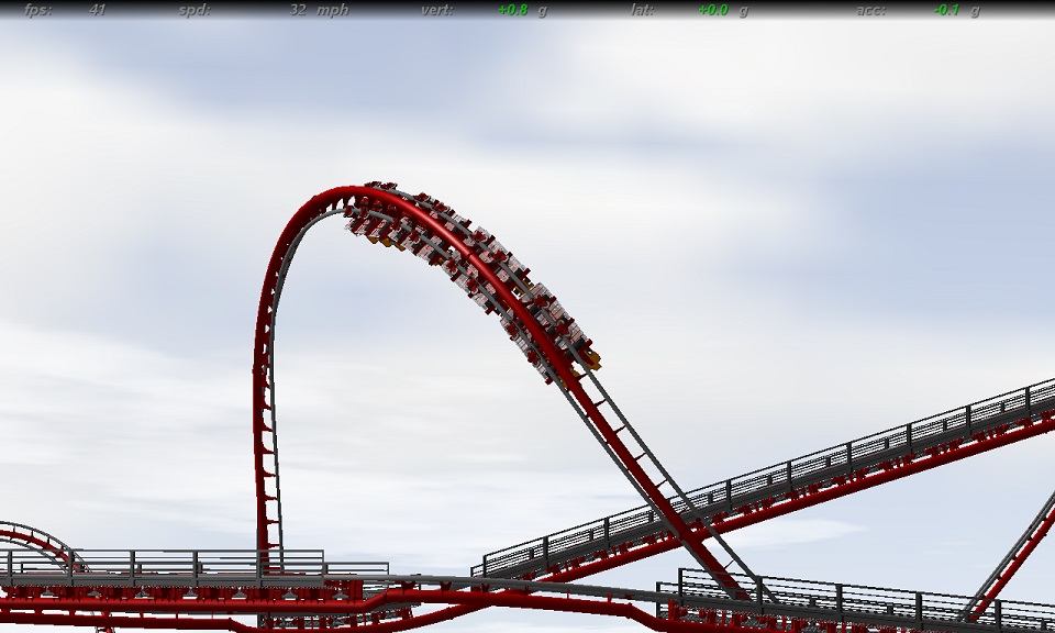

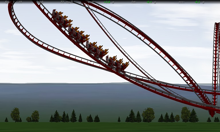

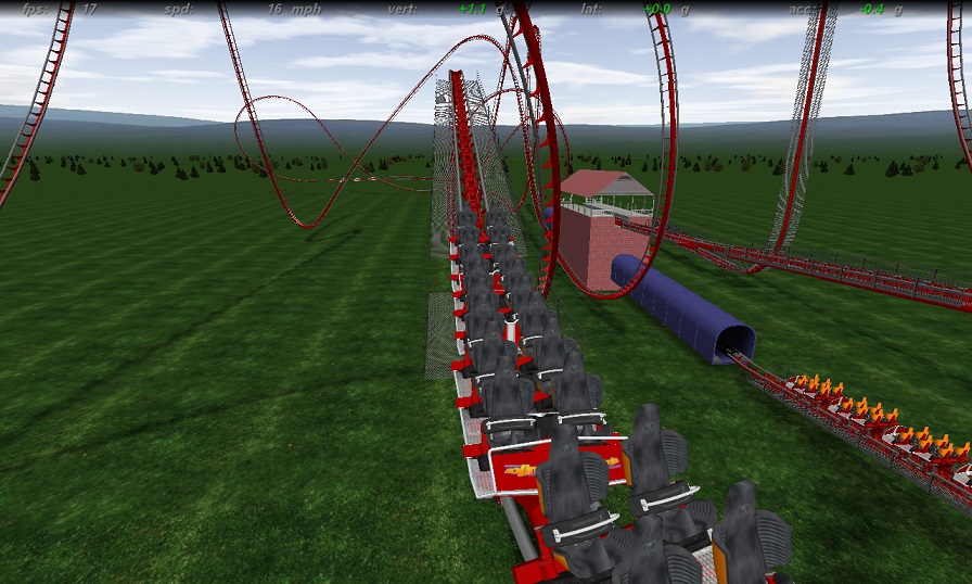

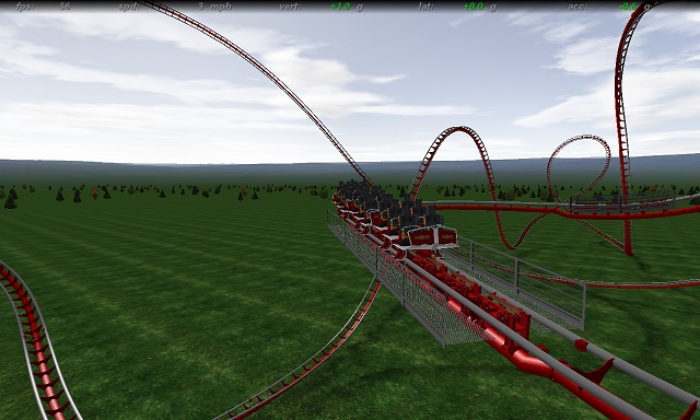

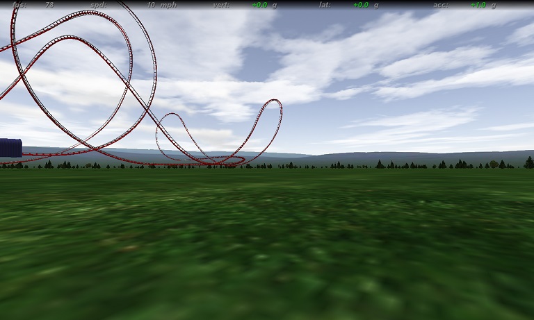

A little project I have been working on, inspired by Maurer Sohne's X-car line and the new Premier Rides launched coaster, Full Throttle at SFMM. The project is named "Over the Edge," but, I am still thinking of a name for the ride, anyone have any suggestions? for the record, names like "Epic Fail-The Ride," or "Facepalm of Death," or "Trollercoaster" will be omitted from the final poll I will have. (maybe)
here's some pics for your viewing pleasure. Track work almost complete, still trying to smooth a few things out, but, layout is 100% done.
118.47 KB
90.37 KB
147.6 KB
135.91 KB
89.44 KB
188.89 KB
85.41 KB
196.6 KB
159.18 KB
132.23 KB
127.14 KB
174.29 KB
115.72 KB[:D]

on-ride Video I posted to show completed layout

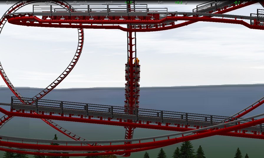

New color scheme
95.57 KB

Anyone want to test this ride? I think I have the track as smooth as it can get, but, a second or possibly 3rd 4th and or 5th couldn't hurt. PS considering that no one seems to be providing feedback in the construction thread, I would appreciate if ALL negative comments are left out of the ratings and comments in the exchange when this is finally uploaded. this is the 4th or 5th time I have created a construction thread and no one comments or provides constructive feedback, yet, when I upload a ride, it all comes out in the ratings. HYPOCRITES!!!

I recommend riding it in the middle car at 50% speed, and with a note pad and pen to take note of all the areas where G forces exceed -1.0G or +4.5G. Also take note of areas where the G forces should be higher, for example the bottom of a drop should reach around 4G, the crest of a hill should be between 0G and -1.5G if you aren't reaching these then you can tighten up your shaping, reduce the radius of turns, lower the crest of hills etc.
As for area's where the G forces are too high, stretch these parts out and increase the radius. With air time hills, it's about sustaining the negative forces rather than a quick blip, so you want a large crest which is less that 0G for at least a couple seconds.

u mad bro? why is it that the x-car gives me the impression that its like going to tilt side to side? [lol] Anyway, the pics look good. Hopefully more get on board and chime in. I think adding some supports would help [;)] The video just stalls for me so I can't even comment on the pacing :(
