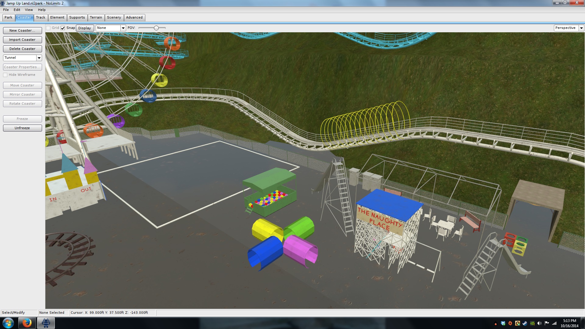

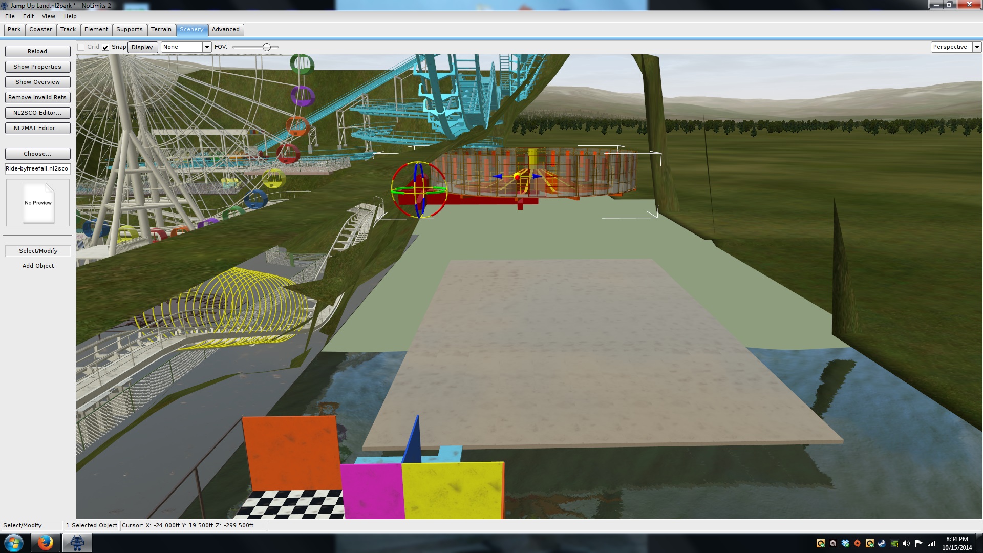

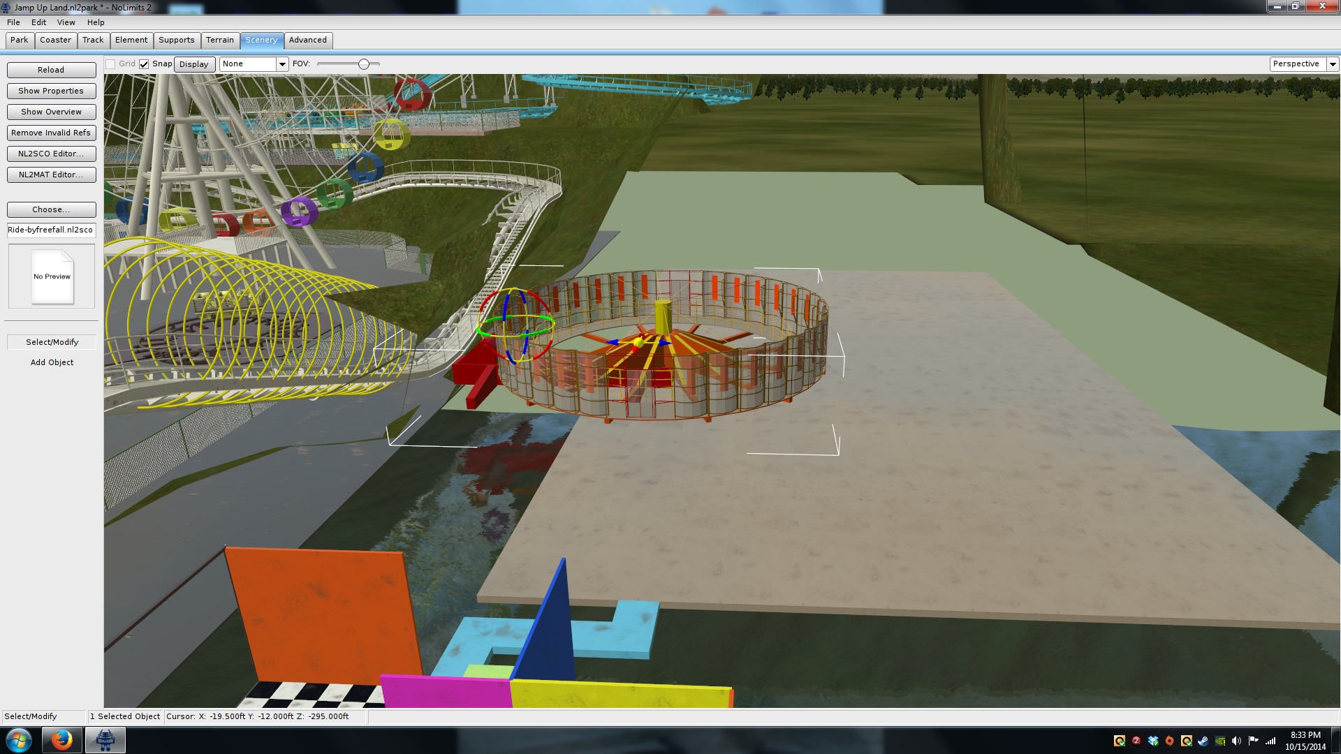

Why will your round up ride not go into this underground area under the hillside roller coaster in my Jamp Up land?
I tried and tried and tried to place it on this area in my future underground carnival next to the underground nightclub but it will not lower to the light brown area that I made for it.
I place it in the middle of the brown area but it raised way up high.

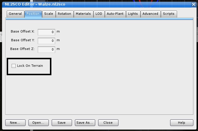

cool5, you would have to edit the ride. there is an option in the NL2SCO, under position, uncheck the "lock on terrain" that will let you move it up and down.

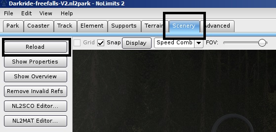

Exactly! Thank you plantoris =) I set the *lock on terrain* to give a possible, fast and easy placement. If you unchecked this function, don??????t forget to reload the object in the scenery tab! :D
First, uncheck the "lock on terrain"
Select the object (if it isn??????t selected) and..
... reload it! Voila :D
Nice greetings =)

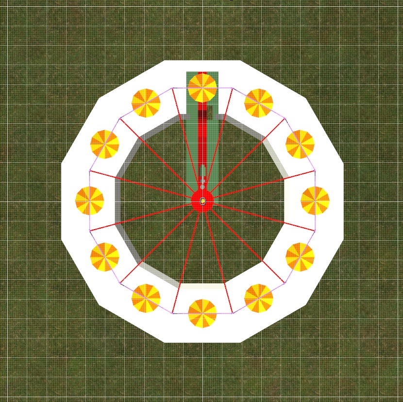

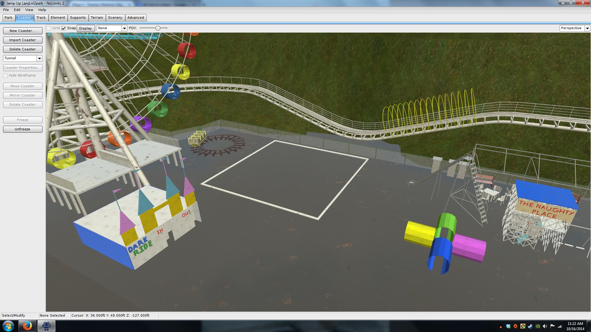

What are the dimensions of the paratrooper ride? Like 12.192 meters by 12.192 meters? Or 40 feet by 40 feet? I have this space marked out in my park.
I really need it to fit in this space. I have other rides that will go in this park too.
Posts: 191
Points on hand: 769.00 Points
I think the raw measures are 15 x 17 meter.
But as i said.. can??????t give you any release date, yet.
Nice greetings.
Why the extra two meters on the one side? The base looks very symmetrical on all sides.
Posts: 191
The gondolas are swinging and the arm is tilting .. there is some room needed to avoid a crash with guests which are walking by ;)
Here is the final future 15X17 meter area for that ride. It just barely fits.

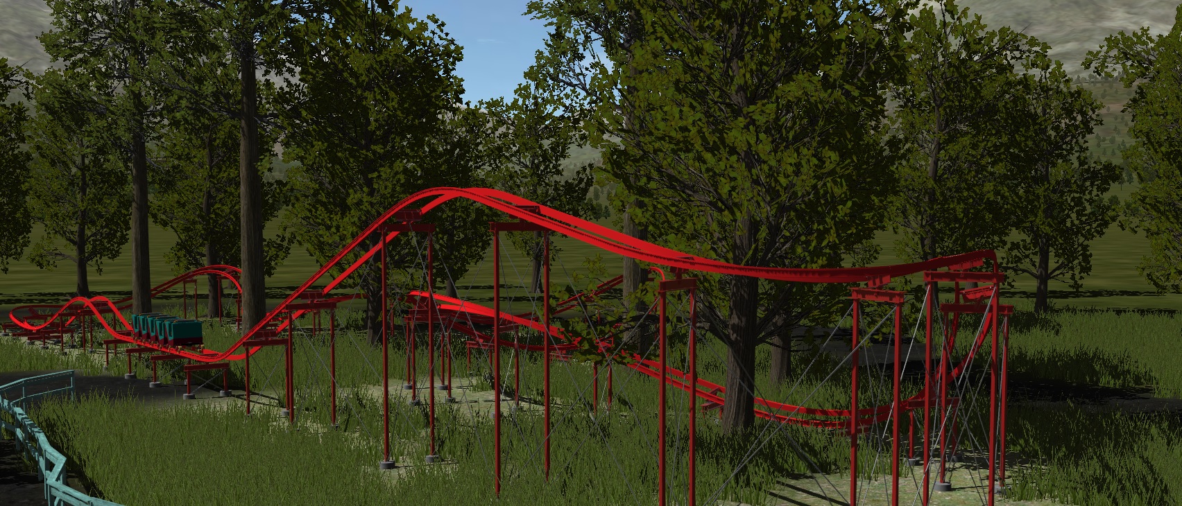

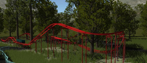

I??????ll update the park with the original "light pattern editor" files.
So you only have to load the "rail settings" into the editor to make the layout.
I kept the trains simple as possible to get high framerates for the "real" coasters in a park.
Posts: 191
Definitely missed that! Awesome stuff Magu! Thanks for sharing!
^^ Presenting the product name as well! Great appeal to the visitors! :D
